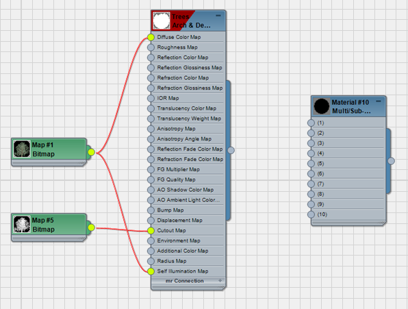

  1. Open the Slate Material Editor.
  2. Zoom out in the active View, then drag a Multi/Sub-Object material from the Browser into the active View, and drop it to the right of the Trees material.
    By default, the Multi/Sub-Object material contains 10 entries, each of which allows you to specify a sub-material. You will use only three of these.
  3. Double-click the Multi/Sub-Object material node so you can see the material parameters.
  4. Name this material Elm Trees.
  5. On the Multi/Sub-Object Basic Parameters rollout, click Set Number. On the Set Number Of Materials dialog, change the value to 3.

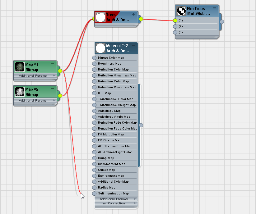

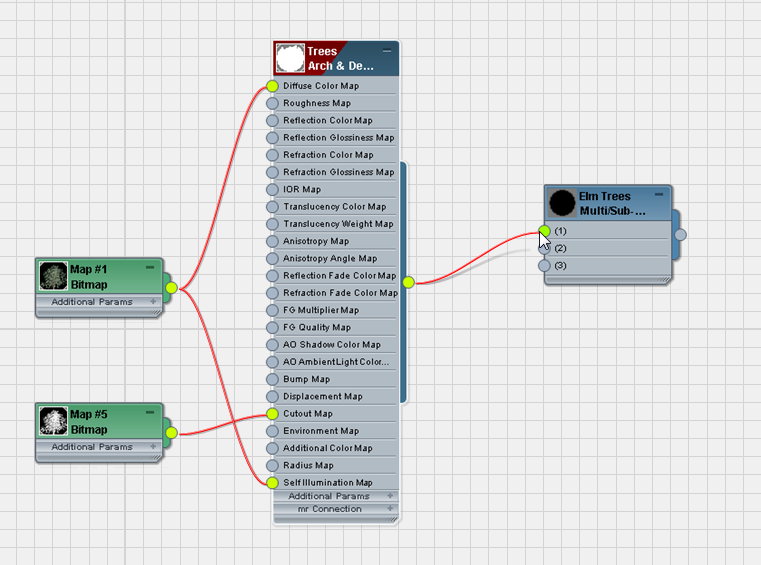

  6. Wire the Trees material node to the (1) sub-material socket of the Elm Trees node.

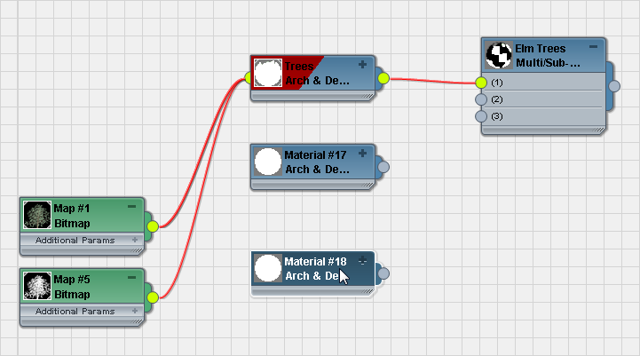

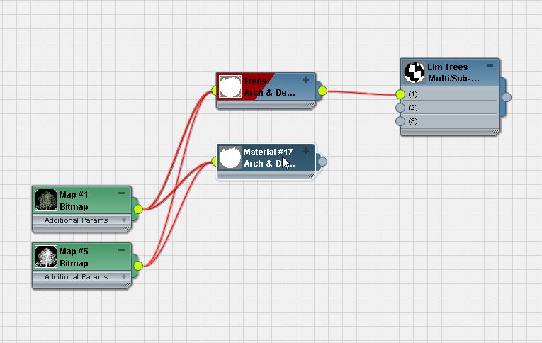

  1. Click the minus-sign (-) icon on the title bar of the Trees material node to collapse this node display, then hold down the key and drag the Trees node to make a copy of it.
  2. Click the plus-sign (+) icon on the title bar of the new material node to open the node display again, then drag away from the input sockets to disconnect the wired bitmaps.
  3. Click the minus-sign (-) icon to collapse the new material node again, then +drag to make another copy.
  4. Double-click the Trees material node so you can see its parameters. Change the name of this sub-material to Elm - Summer.
  5. Double-click the second material node, and change its name to Elm - Fall. On the Slate Material Editor toolbar, turn on (Show Shaded Material In Viewport). (If you use a legacy viewport driver, this button's tooltip reads, "Show Standard Map In Viewport.")
  6. Double-click the third material node, and change its name to Elm - Winter. On the Slate Material Editor toolbar, turn on (Show Shaded Material In Viewport).

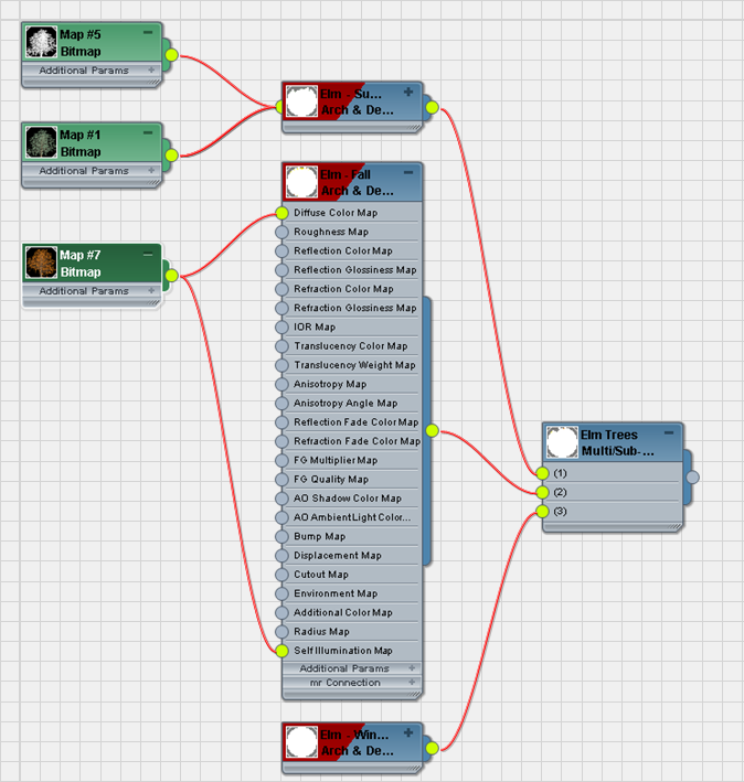

  7. Wire the second and third material nodes to the (2) and (3) sockets of the Elm Trees material node to make them sub-materials as well.

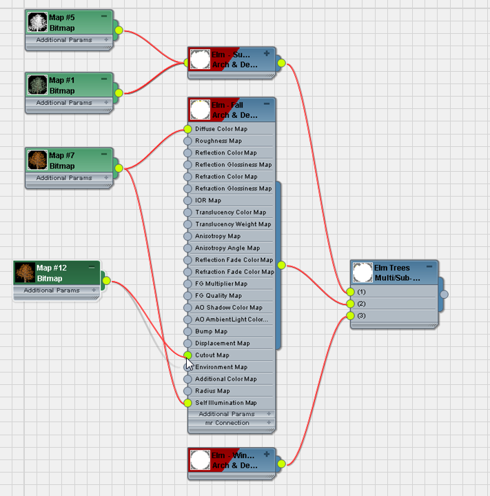

  1. Click the plus-sign (+) icon of the Elm - Fall sub-material node to open the node, then press L so you can see all of the material tree.

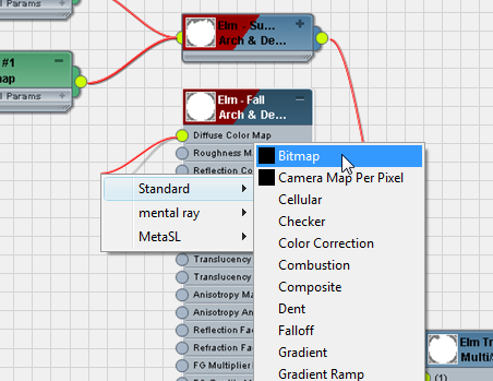

  2. Drag a wire from the Diffuse Color Map socket of the Elm - Fall sub-material node, then release the mouse. From the pop-up menu, choose Standard Bitmap.
    3ds Max opens a file dialog. Choose the elm tree with autumn foliage you rendered in the previous lesson, or navigate to \sceneassets\images and choose elm_fall.tif.
  3. Wire the new Bitmap node to the Self Illumination Map socket as well.
  4. +drag the new Bitmap node to make a copy of it, then wire the copy to the Cutout Map socket of the Elm - Fall sub-material.
  5. Double-click the Bitmap node that is wired to the Cutout Map socket. On the Bitmap Parameters rollout, change Mono Channel Output to Alpha, and RGB Channel Output to Alpha As Gray.
  6. Repeat steps 1 through 5 for the third sub-material node, this time using \sceneassets\images\elm_winter.tif as the bitmap.

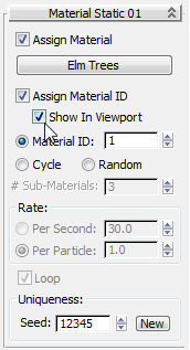

  1. Press 6 to display the Particle View window. Arrange the windows so you can see both the Material Static 001 rollout on Particle View, and the output socket of the Elm Trees material in the Slate Material Editor.
  2. In Particle View PF Source 001, click Material Static 001 to highlight it. Drag a wire from the output socket of the new Elm Trees Multi/Sub-Object material node, and drop it on the Material Static 001 rollout Assign Material button.
  3. In the Instance (Copy) dialog, make sure Instance is chosen, then click OK.

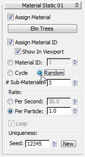

  4. On the Material Static 001 rollout, turn on Assign Material ID and Show In Viewport.
  5. Change the Material ID value from 1 to 2 and 3 to display one of the three different tree sub-materials you set up earlier.
    Elm trees with fall colors: Material ID=2
    Elm trees in winter: Material ID=3
  6. To get a mix of all three tree types, choose Random.
    The Camera01 viewport updates to show a random selection of all three tree types.
    Random assortment of particle trees
    Note: The Random option is not available unless the # Sub-Materials value is greater than 1, so you can't choose this setting until you assign the Elm Trees material to the operator.
  7. In the Material Static 001 rollout Uniqueness group, click New repeatedly until you obtain a mix of tree types that you like.
