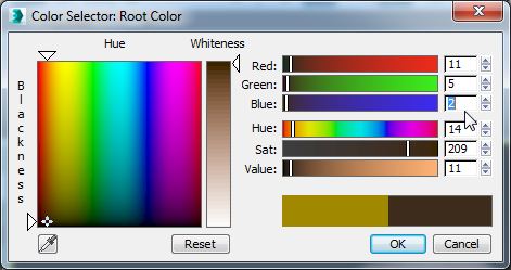

- Open the Material Parameters rollout. Click the Root Color color swatch.
3ds Max opens a Color Selector.
- Change the Root color of the hair to R=11, G=5, and B=2, and then click OK.
This is a very dark brown.

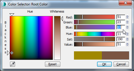

- On the Material Parameters rollout, click the Tip Color color swatch.
- In the Color Selector, change the Tip color of the hair to R=51, G=23, and B=13, and then click OK.
The color at the tip of the hairs is a lighter brown than at the roots.

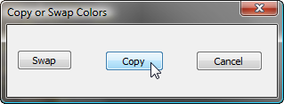

- Drag the Root Color color swatch, and drop it on the Mutant Color color swatch.
3ds Max opens a Copy Or Swap Colors dialog. Click Copy.
- Change the Mutant value to 15.
This value is a percentage: Now Hair will randomly choose 15 percent of the hairs to maintain the Root color: That is, they will be dark instead of graying.

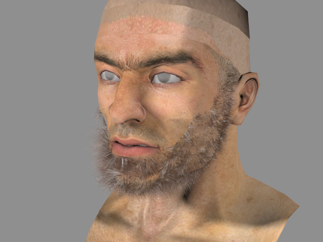

Render the beard:
- On the main toolbar, click
(Render Production). 3ds Max renders the head of the Viking quickly. It takes a more little time to render the beard.
Tip: If you want to reduce the length of the beard, there are two ways to do so, both of them on the General Parameters rollout. Scale keeps the shape of all the hairs, and scales them as a percentage. Cut Length also retains hair shape, but trims hairs from the tip toward the root.
