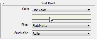

  5. On the Parameter Editor Wall Paint rollout, click the color swatch.
    3ds Max opens a Color Selector.
  6. In the Color Selector, assign these values to the color:
    • Hue: 0.19
    • Sat (saturation): 0.2
    • Value: 1.0
    Now the paint color is a pale yellow.
  7. Click OK to close the Color Selector.
    Leave the paint Finish set to Flat/Matte and the Application set to Roller.

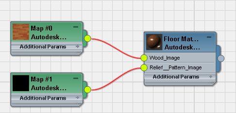

  2. Drag an Autodesk Hardwood entry from the Material/Map Browser to the active View. (This is also in the Materials mental ray group.)
    The Autodesk Hardwood material has two bitmaps built into it. In the Slate Material Editor, click (Zoom Extents) to see the main material node and the two bitmap nodes.
    You will use the first bitmap, which contains the wood grain texture. You won’t use the second bitmap.
    Warning: In 3ds Max, it’s possible to disconnect a bitmap from an Autodesk Material, or to replace it with some other kind of map. However, if you do that other Autodesk applications such as AutoCAD won’t be able to read the Autodesk Material, so we recommend that you always leave the Autodesk Material bitmap nodes as they are. You can change the texture file that they call, or adjust their settings, but don’t disconnect them or replace them with a map type that is supported only by 3ds Max.

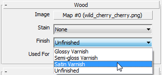

  6. On the Wood rollout, change the value of Finish to Satin Varnish.

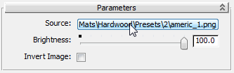

  7. Double-click the first Bitmap node (the one wired to the Wood Image component) to see its parameters.
  8. On the Parameters rollout, click the Source button (at present, the button has the label of the default wood grain map).
    3ds Max opens a Select Bitmap Image File dialog.
  9. In the file dialog, choose Files Of Type All Formats. Navigate to the folder \3ds max 2014 tutorials\sceneassets\images\. Choose cherry.jpg, and then click Open.
  10. After you change the bitmap, the preview in the title bar of the Floor Material node shows the new wood grain.

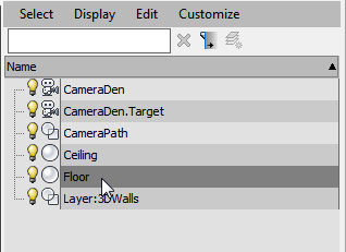

  1. On Scene Explorer panel, click to select the Floor object.
  2. On the Slate Material Editor toolbar, click (Assign Material To Selection).

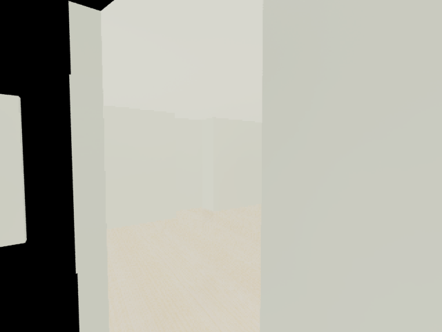

  5. Make sure the CameraDen viewport is active, then on the main 3ds Max toolbar, click (Render Production).
    3ds Max renders the scene with painted walls and a wood-grain floor. (The lighting is uninteresting, but you'll fix that in a later lesson.)
