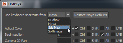

Hotkeys, then on the Hotkeys dialog, choose 3ds Max.

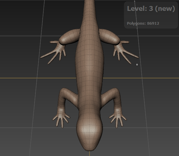

+D three times to increase the model's level of detail.

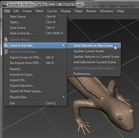

Send the model to 3ds Max:
Send To 3ds Max
Send Selected As New Scene.

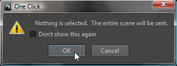

Mudbox displays a warning that you are sending the entire scene. Click OK.

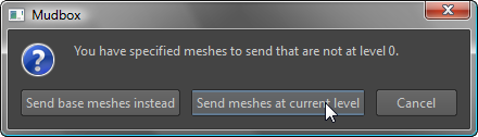

Mudbox displays a message that you are sending meshes that are not at the base level. Click Send Meshes At Current Level.

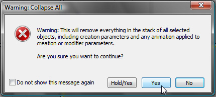

3ds Max displays a warning about collapsing the stack. Click Yes.
