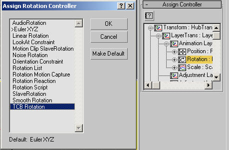

To convert a bone from Euler to quaternion:
Layer Manager rollout, highlight the layer to which to assign the TCB controller.
Now the CATBone will use TCB interpolation for that layer.
