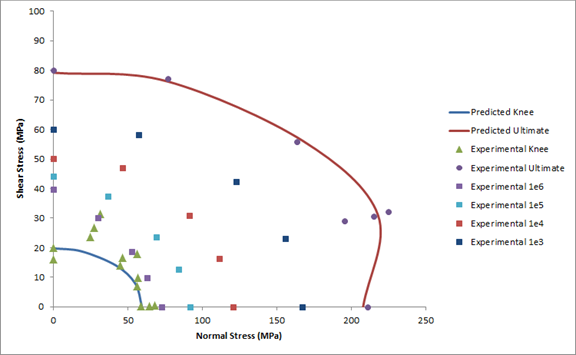

Eq. 47 can be modified to produce a failure index instead of an effective stress as
The values of A i are determined from three composite static failure tests: longitudinal tension, longitudinal compression, and in-plane shear. The failure criteria presented in Eq. 47 has been verified against experimental data and the results are presented below, labeled as Predicted Ultimate.
Note: The failure criteria does an excellent job of predicting ultimate failure loads of a woven lamina subjected to various shear and normal stresses, while only being calibrated to a pure axial and a pure shear stress state.
