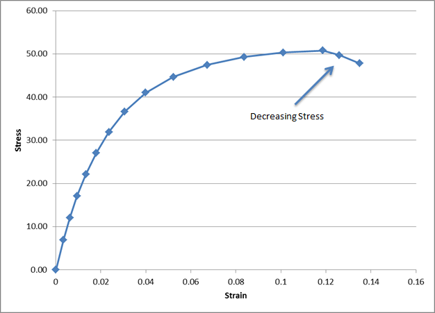

Advanced Material Exchange does not allow stress-strain data to be entered for a material where the stress is decreasing.
Consider the example below where the stress begins to drop following some ultimate stress.
To resolve this issue, you would need to remove the two data points that follow the ultimate stress.
