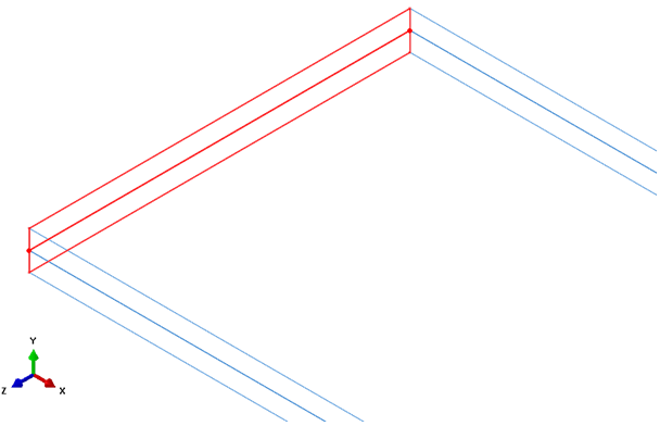

Apply Boundary Conditions
Create a boundary condition that fixes one end of the beam.
  1. Switch to the Load module.
  2. Create a boundary condition (BC > Create) of type Displacement/Rotation and name it Fixed_End.
  3. Select the faces that lie on the YZ-plane at X=0. These faces are highlighted below.
  4. Set the values for U1, U2, and U3 to 0. Click OK.
