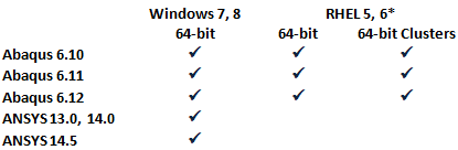

Supported Platforms
Simulation Composite Analysis 2014 supports the following platforms:
* Customers have had success using SLES 11
