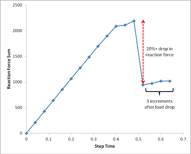

As an example, consider the keyword statement shown below. With these settings, Simulation Composite Analysis will terminate the job 3 increments after the load has dropped 20% or more from one increment to the next. The plot below is an example load-time curve that could result from this keyword configuration.
*JOB TERMINATION, MONITOR=LOAD
0.2, 3
