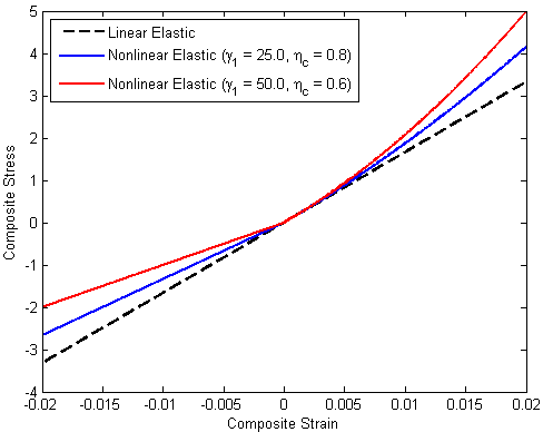

The plot below compares the composite level stress-strain behavior of a material under pure axial loading with different nonlinear parameters (
and ηc). The black dashed line represents the linear elastic response used if the nonlinear elastic fiber model is not enabled.

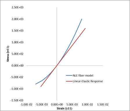

The plot below shows a comparison between the longitudinal stress-strain response using the model given in Eq. 28 for compression and tension.
