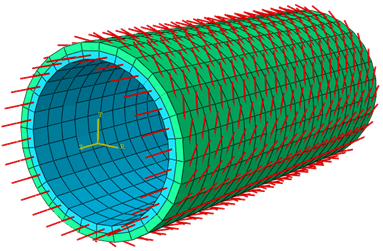

Example
Consider a cylindrical tube composed of two unidirectional composite material plies. Both composite plies are made of the same composite material, but the two plies differ in the orientation of the reinforcing fibers. The reinforcing fibers of the inner ply are aligned with the axial direction of the cylinder, and the reinforcing fibers of the outer ply are aligned with the hoop direction of the cylinder. The red lines in the image below show the orientation of the reinforcing fibers in the inner and outer composite plies.
To illustrate the consequences of specifying a value of 2 for the second user material constant, consider the following statements that are excerpted from an Abaqus input file. The second user material constant is assigned a value of 2 indicating that the '2' axis of the principal material coordinate system is aligned with the reinforcing fibers. Note that ** indicates a comment in an Abaqus input file.

Notice that the orientation of the local cylindrical coordinate systems (given in the *ORIENTATION statements) must be consistent with the convention chosen for the principal material coordinate system. For example, the local cylindrical coordinate system for the inner ply is rotated so that the local '2' axis always points in the global axial direction. In contrast, the local cylindrical coordinate system for the outer ply does not need to be rotated since its local '2' axis always points in the global hoop direction.
