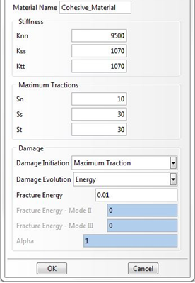

In the following steps, a user-material is defined using the Create Cohesive Material plug-in.
  1. Select Plug-ins > Autodesk > Create Cohesive Material from the main toolbar.
  2. Enter Cohesive_Material for the Material Name, 9500 for Knn, 1070 for Kss and Ktt, 10 for Sn, and 30 for Ss and St.
  3. Select the Maximum Traction Initiation Criterion and Energy Softening Type and enter a Fracture Energy value of 0.01.
  4. The dialog box should appear as shown below. Click OK to create the material.
