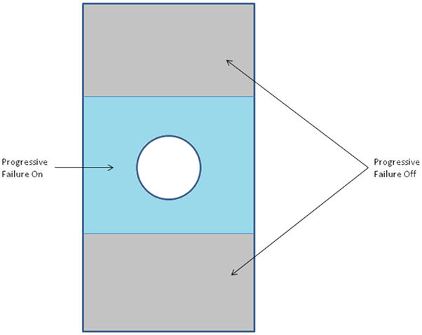

As an example, consider the open hole coupon shown below. Here, it is desired to deactivate progressive failure in the regions away from the stress concentration, which requires two different materials.
The only way to tell Abaqus that different materials are to be used for the two regions is to create two material definitions and assign the materials to the two regions. When used with Simulation Composite Analysis, each material would have a corresponding *USER MATERIAL card as shown below.
