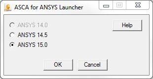

  1. Open ANSYS Mechanical APDL using the ASCA for ANSYS Launcher tool shown below. This tool launches ANSYS with the necessary environment variables to run Simulation Composite Analysis with ANSYS.
    This tool is installed with Simulation Composite Analysis and can be accessed from the desktop shortcut. It can also be found at the following path:
    %install_dir%\bin\ansys-compan-launcher.exe
  2. Click the Run button in the ANSYS Mechanical APDL Product Launcher to open the ANSYS GUI.
