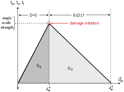

In the graphic above,
denotes the value of the effective relative displacement
at damage initiation, e.g., at the time when
becomes satisfied.
at which the material stiffness has fully degraded to zero.
denotes the maximum value of the effective relative displacement
that has been attained by the material to date for any time t less than or equal to the current time. Note that
and
are considered to be part of the material characterization.
For any values of
within the range
, the current value of damage variable D can be expressed via the following damage evolution equation.
