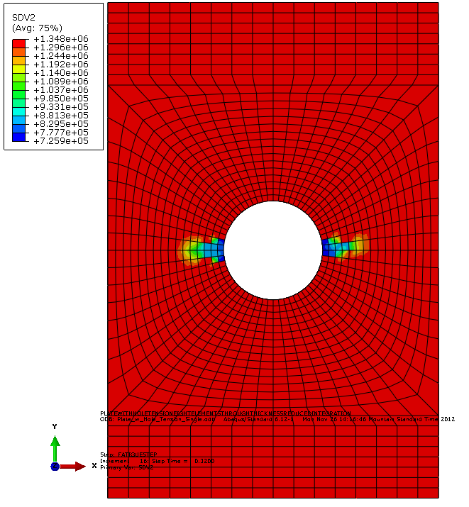

Any of the above state variables may be viewed on a contour plot of the structure by following the steps outlined in this document. An example contour plot of the cycles to failure for an open hole tension specimen in Abaqus Viewer is given below.
Note that the cycles to failure for the majority of the structure are at 1.3E+06, while the region around the hole has experienced fiber failure at much lower cycles to failure.

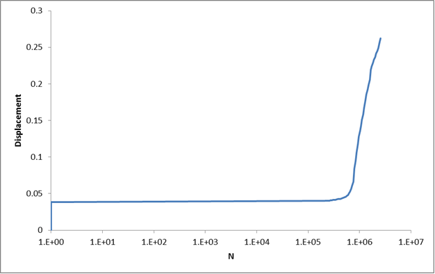

You can also use nodal displacements and the cycles to failure for un-failed regions of the structure to plot the cycles to structural failure. The example above is load-controlled, and the displacements of the top of the plate are all equal. If we plot the number of cycles in any un-failed region as a function of the displacement of the top of the plate, we can generate a plot similar to that below.
Note that at approximately 1E+06 cycles the structure begins to deform excessively, which is the indication of catastrophic structural failure.
