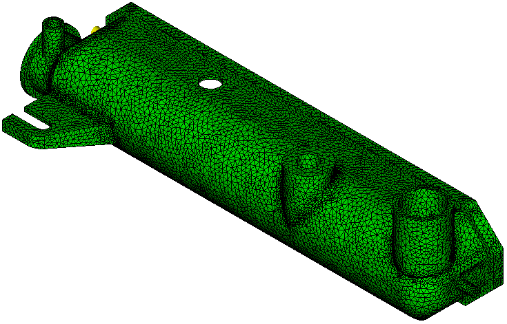

Import a Study
Open Moldflow Insight Ultimate and create a new project (
Start & Learn
Launch
New Project
Name the project
Radiator Tank
and click
OK
Import the model named
radiatortank.sdy
Home
Import
Import
Parent topic:
Tutorial 2 - Analyze an Injection-Molded Radiator Tank
