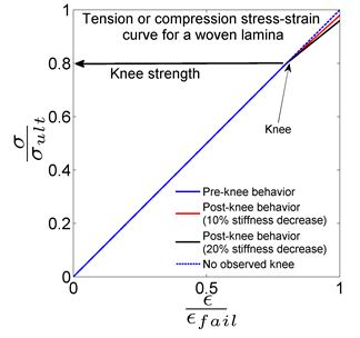

To overcome this challenge, we use what is commonly termed "knee strength" to characterize the matrix. The knee strength, which has been widely observed experimentally [1-11], is simply the stress level in a standard tensile, compressive, or shear test when the stress-strain curve changes slope. This slope change results from failure in the intra-tow matrix transverse to loading, as has been validated by acoustic emission studies (e.g., [1,7,11]). An idealization of this behavior for tensile or compressive loading is shown below, where the stresses and strains are normalized by their respective ultimate failure levels. Initially, a linear response is observed up to the knee strength. The post-knee behavior will depend on the stiffness reduction. The red and black curves correspond to a 10% and 20% stiffness reduction, respectively. The dashed curve shows the behavior if no knee were observed. Note that the knee may not be immediately obvious from a cursory glance at the curve.
