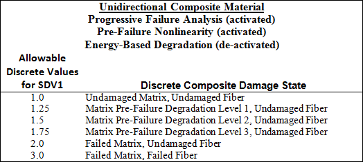

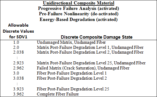

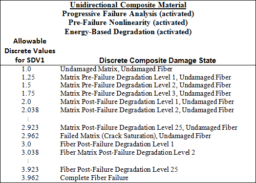

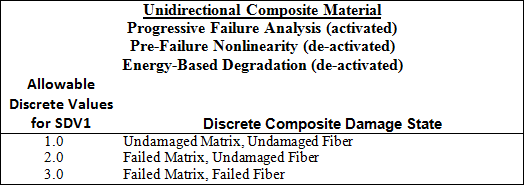

SDV1 (often renamed as MAT_STATE) is a real variable that represents the discrete damage state of the composite material. It assumes a finite number of discrete values between 1 and 3. The number of discrete values assumed by SDV1 and the interpretation of those discrete values depend upon the type of composite material (i.e. unidirectional or woven) and the specific set of material nonlinearity features employed to describe the material's response. The following tables provide the interpretation for each allowable discrete value of SDV1 for each possible combination of composite material type and set of material nonlinearity features.
Unidirectional Composites - Static Analyses
For
unidirectional composite materials, state variables SDV2, SDV3, ..., SDV35 have the following interpretations for static progressive failure analyses:

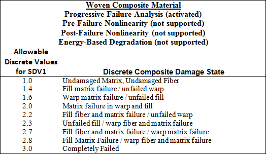

Woven Composites - Static Analyses
For
woven composite materials, state variables SDV2, SDV3, ..., SDV90 have the following interpretations for static progressive failure analyses:
- SDV2
- SDV2 (also known as FI_FILL_MATRIX) is a continuous real variable that ranges from 0.0 to 1.0. It is used to indicate the fraction of the matrix failure criterion that has been satisfied for the matrix constituent within the fill tows.
- SDV3
- SDV3 (also known as FI_FILL_FIBER) is a continuous real variable that ranges from 0.0 to 1.0. It is used to indicate the fraction of the fiber failure criterion that has been satisfied for the fiber constituent within the fill tows.
- SDV4
- SDV4 (also known as FI_WARP_MATRIX) is a continuous real variable that ranges from 0.0 to 1.0. It is used to indicate the fraction of the matrix failure criterion that has been satisfied for the matrix constituent within the warp tows.
- SDV5
- SDV5 (also known as FI_WARP_FIBER) is a continuous real variable that ranges from 0.0 to 1.0. It is used to indicate the fraction of the fiber failure criterion that has been satisfied for the fiber constituent within the warp tows.
- SDV6
- Not Used

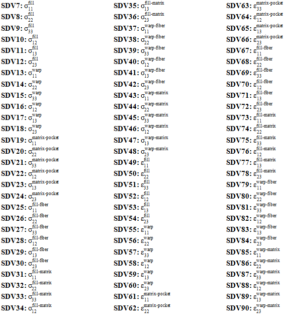

For the case of woven composites, the remaining MCT state variables are used to store the individual components of the average stress and strain states in the various superconstituents and constituents (e.g., fill = fill tow superconstituent, warp = warp tow superconstituent, matrix-pocket = matrix constituent of the intertow matrix pockets, fill-matrix = the matrix constituent of the fill tow, warp-matrix = the matrix constituent of the warp tow, fill-fiber = the fiber constituent of the fill tow, warp-fiber = the fiber constituent of the warp tow).
