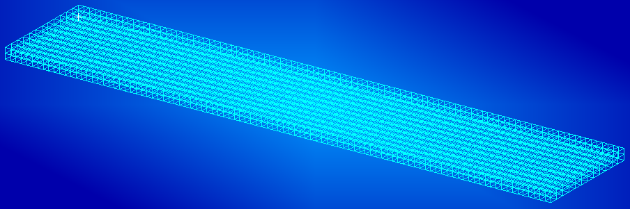

  1. Open Patran (2013 or later).
  2. Create a new database (File > New) named ASCA_Tutorial_4_Nastran.db. Make sure the Analysis Code is set to MSC.Nastran and the Analysis Type is set to Structural.
  3. Click File > Import and navigate to the location of ASCA_Tutorial_4_Nastran.bdf. Make sure the Source is set to MSC.Nastran Input.
    Note: The bulk data file ASCA_Tutorial_4_Nastran.bdf can be downloaded here.
  4. Click Apply to import the mesh. The beam should appear as shown below.
