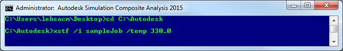

Simulation Composite Analysis supports temperature dependent material properties for unidirectional composites. If the input file supplied to xStiff contains such a material, it may be necessary to evaluate the extraneous stiffness parameters using material properties at a specific temperature. To do so, the /temp argument can be supplied in the Command Shell. The image below shows an example of supplying the temperature of the model via the Command Shell.
