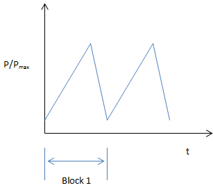

    *FATIGUE, STEP=2
    *BLOCK, REPEATS=2
    0.1, 0.0
    1.0, 0.1
    0.1, 0.13
  3. The load history specified represents the fatigue loading shown below
