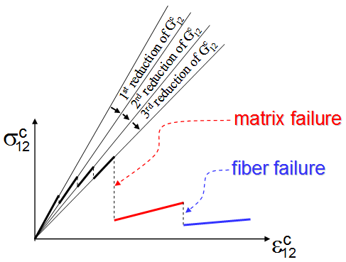

Within the region labeled Damage State 1 in Part A of the plot mentioned above, the Simulation Composite Analysis pre-failure nonlinearity feature employs a four-segment, piecewise linear representation of the longitudinal shear response (i.e., vs. and vs. ). The original linear elastic response for the remaining four stress and strain components is maintained. The plot below provides a qualitative illustration of the composite average longitudinal shear response ( vs. and vs. ) that occurs when the Simulation Composite Analysis pre-failure nonlinearity feature is invoked. In this plot, prior to any matrix or fiber constituent failure, the composite average longitudinal shear moduli ( and ) undergo a series of three discrete reductions. The discrete reductions in and are produced entirely by consistent discrete reductions in the matrix average longitudinal shear moduli and while all other matrix and fiber constituent properties remain constant. This procedure is intended to simulate the gradual accumulation of sub-microcracks in the matrix that occurs prior to complete matrix shear failure.
Note, the implementation of this feature requires only six additional pieces of information (i.e., six constants) that identify the three fractional reductions imposed on and and the three levels of matrix average longitudinal shear stress ( and ) at which these reductions are imposed. Obviously, the determination of these constants requires a measured longitudinal shear stress/strain curve (e.g., vs. ) for the composite material in question. It should be emphasized that invoking this feature does not change the shear stress level at which matrix failure occurs. However, it does increase the amount of shear deformation that occurs prior to matrix failure.
