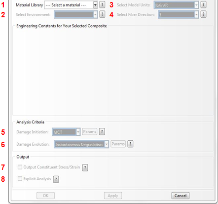

To open the Create Composite Material GUI from within Abaqus/CAE, go to the main toolbar and select Plug-ins > Autodesk > Create Composite Material. The GUI will appear as shown below.
As shown above, there are several options involved in using the Create Composite Material GUI to define a composite material type for Simulation Composite Analysis. Each of the options is discussed below.
  1. Composite Material Selection - Select a composite material from the Simulation Composite Analysis material library. If the material library does not contain a composite material that you would like to use in an analysis, a material data file must first be created and added to the material library (refer to the Material Manager User's Guide). Once a composite material is selected, the homogenized (or composite average) engineering constants for that material will be displayed in the GUI.
  2. Environment Selection - If the selected material contains material properties for multiple environments (combination of temperature and moisture), you should select the environment that you wish to use during the analysis. Once selected, the material properties for the environment will be displayed in the GUI.
  3. System of Units - Select the system of units that should be used to compute constitutive relations and stresses. By default, Simulation Composite Analysis expresses constitutive relations and computes stress in the (N/m/K) system of units. If the finite element model is created using a different system of units, Simulation Composite Analysis must convert its constitutive calculations to the system of units required by the model. For such purposes, Simulation Composite Analysis contains conversion factors for four commonly used systems of units: N/m/K, N/mm/K, lb/in/R, and lb/ft/R. If the finite element model uses one of these four systems of units, you must select the appropriate system from the drop-down list. In the event that the model's system of units does not appear in the drop-down list, you should select the default system of N/m/K and then refer to The HIN File section for details on how to use the HIN file to define a custom set of units.
  4. Principal Material Coordinate System - Simulation Composite Analysis expresses constitutive relations and computes stresses in the principal material coordinate system of the composite material. Here you select one of two or three possible orientations for the composite's principal material coordinate system.
    For Unidirectional Microstructures: The default principal material coordinate system is oriented with the '1' direction aligned with the fiber direction, while the '2' and '3' directions lie in the material's plane of transverse isotropy. This default orientation of the principal material coordinate system corresponds to the selection of "1" from the fiber direction drop-down menu. However, in situations where it adds convenience or simplicity to the model creation process, you may change the orientation of the principal material coordinate system so that the '2' direction is aligned with the fiber direction, while the '1' and '3' directions lie in the composite material's plane of transverse isotropy. This particular orientation of the principal material coordinate system corresponds to the selection of "2" from the fiber direction drop down menu. If you select the value '2' from the drop-down list, the transformed properties are displayed in the GUI.
    For Woven Microstructures: The default principal material coordinate system is oriented with the '1' direction aligned with the fill tow direction, while the '2' direction corresponds to the warp tow direction, and the '3' direction corresponds with the out-of-plane direction. This default orientation of the principal material coordinate system corresponds to the selection of "1" from the fiber direction drop down menu. However, in situations where it adds convenience or simplicity to the model creation process, you may change the orientation of the principal material coordinate system so that the '2' direction is aligned with the fill tow direction, while the '1' direction corresponds to the warp tow direction. This particular orientation of the principal material coordinate system corresponds to the selection of "2" from the fiber direction drop-down menu. Additionally, you may change the orientation of the principal material coordinate system so that the '3' direction is aligned with the fill tow direction while the '2' direction corresponds to the warp tow direction. This particular orientation of the principal material coordinate system corresponds to the selection of "3" from the fiber direction drop down menu.
  5. Damage Initiation Criterion Selection - Choose which failure criterion you would like to use for the selected material. The criterion chosen only dictates the initiation of failure and not the progression of damage. For unidirectional composites the available options are:
    For woven composites the available options are:

    The "Params" button will become available if a selected criterion has additional parameters that must be provided. By clicking this button a new window will open allowing you to define the parameters required for the selected criterion. The parameters that must be defined for each criterion are:

  6. Damage Evolution Method Selection - Select the method to use for the computation of damage evolution (stiffness reduction). There are three available options:

  7. The "Params" button will become available if a selected method has additional parameters that must be provided. By clicking this button a new window will open allowing you to define the parameters required for the selected method. The parameters that must be defined for each method are:

  8. Output Constituent Average Stress and Strain States - Choose whether or not to output the fiber average stress and strain fields and the matrix average stress and strain field to the output database file (.odb file). If you check this box for a unidirectional composite, the number of MCT state variables output to the .odb file increases from 7 to 35 (11 to 35 if Energy-Based Degradation is requested). If you check this box for a woven composite, the number of MCT state variables output to the .odb file increases from 7 to 90. Printing these extra state variables increases the total run time slightly and significantly increases the size of the .odb file. Thus, this option should only be selected if the constituent average stress and strain states are of interest.
  9. Explicit Analysis - Choose whether or not this material will be used for an Abaqus/Explicit analysis. Selecting this option will create the material with the correct number for the *DEPVAR definition and will also create the *DENSITY definition if a density for the material is available (it must have been provided when the material was created with Composite Material Manager).
After completing the above selections, click the OK button on the GUI to create a user-defined composite material that is compatible with Simulation Composite Analysis. Once the OK button is clicked, a new material will be created in Abaqus/CAE and the appropriate Abaqus keyword statements are added to the model.
