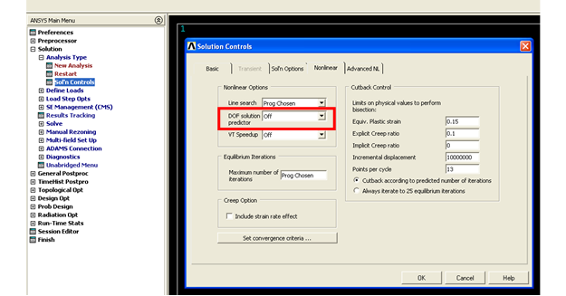

PRED
The PRED command prevents ANSYS from using the converged solution at the last substep to estimate the solution for the current substep. This interferes with Simulation Composite Analysis' method of managing material linearity. The image below shows how to access this command via the ANSYS Mechanical APDL. As seen below, the "DOF solution predictor" drop-down menu needs to have "Off" selected.

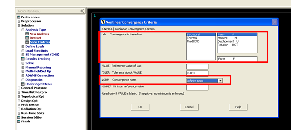

The CNVTOL command is used to define the convergence tolerance for residual node forces. There are two arguments set in this command that allow Simulation Composite Analysis to better handle the nonlinear solution process: a) set forces (F) as the convergence label, and b) set the norm selection to infinite norm (check each DOF separately). The image below displays where to set these arguments in the ANSYS Mechanical APDL.

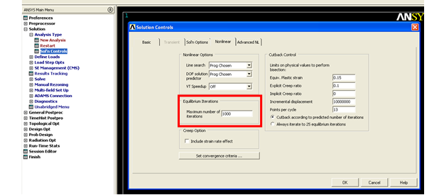

NEQIT
The NEQIT command is used to specify the minimum number of equilibrium iterations that must be performed before ANSYS evaluates the need for cutting-back the size of the current substep. Simulation Composite Analysis has the unique ability to converge regardless of the substep size or extent of nonlinearity occurring during the substep. In the experience of Autodesk, convergence always occurs when the number of equilibrium iterations allowed per substep, before a substep cutback occurs, is set to 1000. The image below displays how to set this argument via the ANSYS Mechanical APDL.
