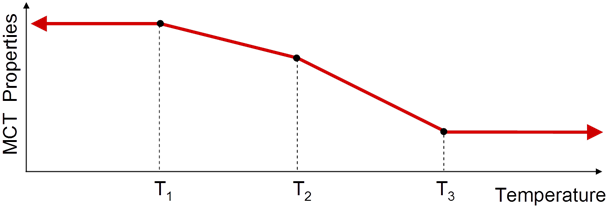

Temperature Dependence
For this feature to influence results, the material must be characterized at multiple environments. When temperature dependence is active, composite and constituent properties are interpolated linearly for any given temperature that lies within the bounds of the lowest and highest temperature points stored in the material file. For temperatures below the lowest stored temperature datum, material properties stored at the lowest temperature datum are used (Simulation Composite Analysis will not extrapolate properties beyond the bounding stored temperature data points). The same is true for temperatures above the highest stored temperature datum. This linear interpolation of material properties is illustrated below.
