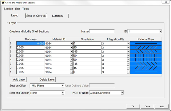

  1. Select Main Menu > Preprocessor > Sections > Shell > Lay-up > Add/Edit.
  2. Since the plate is eight plies thick, click the Add Layer button until there are eight layers.
  3. Enter 0.005 for all thickness values.
  4. Enter the orientations for plies 1 thru 8 as 0, 45, -45, 90, 90, -45, 45, 0, respectively. The dialog box should appear as shown below. Note the Material ID values may differ depending on the materials in your Material Library.
  5. Click OK.
