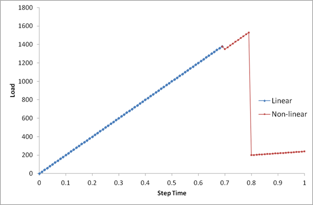

The solution of a progressive failure model can be divided into a linear portion and a non-linear portion. In terms of material nonlinearity, the distinction between the two portions lies in material failure. The linear portion is characterized by the absence of material failure while the nonlinear portion is characterized by the presence of material failure. Ideally, a single increment would be used in the linear portion and many increments would be used in the nonlinear portion to accurately resolve the propagation of damage. With this in mind, it is often the case that a significant portion of the solution is linear. Depending on the incrementation scheme, this can mean that much of the solution time is devoted to solving the linear portion of the solution. For example, consider the load-time plot shown below which color codes the linear and nonlinear portions of the solution for a model with a fixed increment size. Clearly, a majority of the increments are in the linear portion and this time is essentially wasted because the problem is linear until material failure initiates.

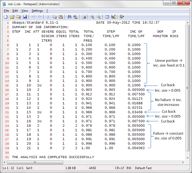

Abaqus input file:
*STATIC
0.1, 1.0, 1.0e-05, 0.1
HIN file:
*DAMAGE TIME STEP
0.005
Since the initial and maximum increment sizes are 0.1, the increment size remains fixed at 0.1 until failure is predicted by Simulation Composite Analysis. When failure is predicted, the solution will cut back to the previously converged increment, then progress using a starting increment size of 0.005. Once failure occurs the increment size will remain at 0.005 for the remainder of the analysis. So instead of using a fixed increment size of 0.005 for the entire solution, a relatively large increment size is used for the linear portion and 0.005 is used for the nonlinear portion. By reducing the number of increments devoted to the linear portion, the overall run time is reduced considerably. The scenario above is demonstrated with the example .sta file shown below.
