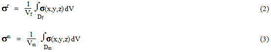

where V is the total volume of the RVE. Similarly, the fiber and matrix average stress states can be expressed as
where Vf and Vm are respectively the volumes of the fiber and matrix constituents within the RVE (V=Vf +Vm), and Df and Dm denote respectively the subdomains occupied by the fiber and matrix constituents within the RVE (D = Df Dm). Combining Eqs. 1-3 yields
where φf = Vf/V and φm = Vm/V are volume fractions of the fiber and matrix constituent materials respectively.

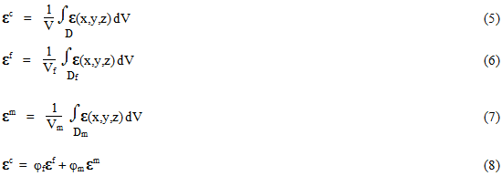

Similar reasoning can be applied to the strain tensor yielding Eqs. 5-8 below.
Note: There are no restrictions on the validity of Eqs. 1-8; they are valid for any type of constitutive behavior and any level of deformation.

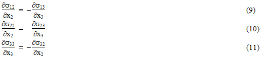

While it is easy to appreciate that averaging the actual micromechanical stress field over individual constituents provides superior information with which to predict damage evolution and failure in composites, it is informative to consider the filtering characteristics of the volume averaging process as it pertains to the various average stress states. Let us begin by considering a representative volume element of a unidirectional fiber-reinforced composite material subjected to a simple homogenized composite stress state σc. For example, a uniaxial stress state where > 0 and all other = 0. Even though the composite average stress state is uniaxial, the actual micromechanical stress field σ(x,y,z) within the heterogeneous microstructure of the RVE is quite complex. This is due to self-equilibrating interactions between the constituent materials caused by differences in their stiffnesses, Poisson ratios, and thermal expansion coefficients. For example, in the actual micromechanical stress field, four of the six stress components ( σ11, σ22, σ33, σ23) achieve non-zero values within the RVE. Furthermore, these four stress components exhibit a high degree of spatial variation over the RVE with numerous localized stress concentrations. However, three of the actual stress components ( σ11, σ33, σ23) are due entirely to self-equilibrating interactions between the constituent materials. For example, differences in the Poisson ratios of the fiber and matrix are responsible for the development of self-equilibrating σ11(x,y,z) and σ33(x,y,z) fields. In the presence of spatially varying σ11(x,y,z), σ22(x,y,z) and σ33(x,y,z) fields, shear stress must develop to maintain local equilibrium. Equations 9-11 show the partial differential equations of equilibrium that have been simplified for the present case of a unidirectional composite RVE where all stress components are constant with respect to the fiber direction (i.e., the '1' direction).
Equations 10 and 11 imply that shear stress component σ23 must evolve at any point within the RVE where or are non-zero. Unfortunately, these self-equilibrating stress components (σ11, σ33, σ23) are completely filtered out by the process of averaging the micromechanical stress field over the entire RVE, thus the composite average stress state is uniaxial with > 0.
