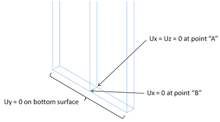

Create boundary conditions that minimally constrain the movement of the bottom surface of the plate and prevent rigid body movement.
The boundary conditions are shown below.
  1. Select Preprocessor > Loads > Define Loads > Apply > Structural > Displacement > On Areas.
  2. From the Graphics Window, select the 2 bottom surfaces of the plate and click OK in the Apply U,ROT on Areas dialog box.
  3. In the dialog box that appears, enter a Displacement value of 0 for UY and click OK.
  4. Select Preprocessor > Loads > Define Loads > Apply > Structural > Displacement > On Keypoints.
  5. Select point "A" and set UX and UZ equal to 0.
  6. Repeat steps 4 and 5, selecting point "B" and setting just UX to 0.
