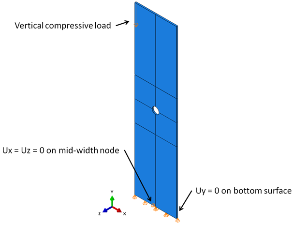

The model consists of a 6 x 1.5 in. plate with a 0.125 in. radius hole located in the center of the plate and uses C3D8 elements. The layup is [45/-45/0/902]S and the ply thickness is 0.005 in. which results in a plate thickness of 0.05 in. The initial temperature of the plate is modeled at 72°F and the test temperature of the plate is 140°F. In the first analysis step, the temperature of the plate is increased to 140°F and in the second step a displacement controlled compressive load is applied to the plate until ultimate failure. It is strongly recommended that thermal loads be applied in a step prior to mechanical loading as the thermally induced displacements can cause a large shift in the load-displacement curve, which can make interpretation of the load-displacement curve cumbersome. The loading and boundary conditions are shown below where the 0° ply orientation is aligned with the global y-axis.
