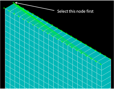

First, a coupling constraint is applied to the nodes on the top surface that allow for a simple determination of the total reaction force during post-processing.
  1. Select Preprocessor > Coupling / Ceqn > Cupl DOFs w/Mstr.
  2. Pick all nodes on the top surface of the plate, making sure that the first node picked is the node indicated in the image below. Click OK.
  3. Set the reference number to 20 and the degree-of-freedom label to UY. Click OK to complete the coupling definition.
  4. As a consequence of the coupling constraint, a displacement in the y-direction applied to the node highlighted below will result in the same y-displacement applied to the remaining nodes in the constraint definition.
  5. Select Preprocessor > Loads > Define Loads > Apply > Structural > Displacement > On Nodes and select the node indicated below.
  6. Apply a UY value of 0.06 and click OK.
