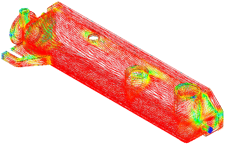

Review Results
Click
Home
Results
Results
Click
Fiber orientation tensor
in the study tasks list.
Rotate the model as necessary to see the predicted orientations for our glass fiber reinforced material.
