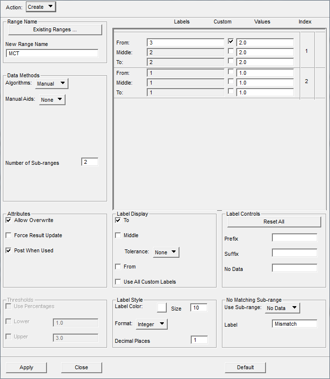

Because SV2 is a discrete real value between 1 and 4, it is important to change the contour plot settings so that a unique color contour is associated with each discrete integer value of SV2. In the case where SV2 can assume values of 1.0, 2.0, or 3.0, set the color spectrum to include just three colors and modify the range of values associated with each color.

  4. The next step is to define a range. Click Display > Ranges... and create a new range in the window that appears.
  5. Give the range a name, set the Data Methods Algorithm to Manual, and set the Manual Aids to None.
  6. Set the Number of Sub-ranges to 2 and check on the To box in the Label Display window.
  7. Now define the range as shown below.
    The blue color is now associated with SV2 = 1.0, green with SV2 = 2.0, and red with SV2 = 3.0.
  8. Finally, set the Action to Assign to Viewport and click Apply.

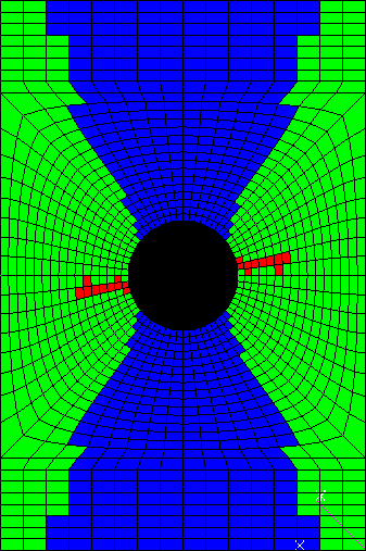

The image below shows a contour fringe plot of SV2 for an axially loaded composite plate with a central hole. The use of three discrete colors makes it easy to identify the regions where each discrete composite damage state occurs. The blue elements (SV2 = 1) are undamaged, the green elements (SV2 = 2) have failed matrix constituents and undamaged fibers, and the red elements (SV2 = 3) have failed matrix and fiber constituents. In this plot, the element averaging domain has been set to None, so that each element retains its value at the element nodes.
