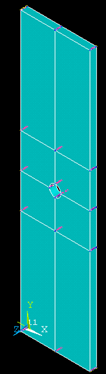

In meshing the composite plate, a global seed size of 0.075 is used to ensure the mesh is fine enough to capture the location and propagation of failure, but coarse enough to allow for a moderate solution time. Manual edge seeding is used to ensure there is a single element in the thickness direction and the area concatenation tool is allows for a mapped mesh around the hole.

  7. Since a single element will be used to define the entire 24 ply layup, manual seeds must be specified on the lines parallel to the global Z-direction.
  8. From the top menu, click Select > Everything. Then click Plot > Replot.
  9. Click Preprocessor > Meshing > Size Cntrls > ManualSize > Lines > Picked Lines.
  10. Select all of the lines parallel to the global Z-direction as shown below. Click OK.
  11. In the dialog box that appears, enter a value of 1 in the NDIV entry box. Click OK.
