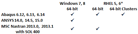

Supported Platforms
Simulation Composite Analysis 2015 (November 2014) supports the following platforms:
* Customers have had success using SLES 11
The Advanced Material Exchange tool currently supports the Abaqus versions listed above. It operates on the Windows and Linux platforms listed in the table.
