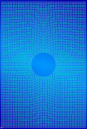

  4. Click Apply to import the mesh. The coupon should appear as shown below.
