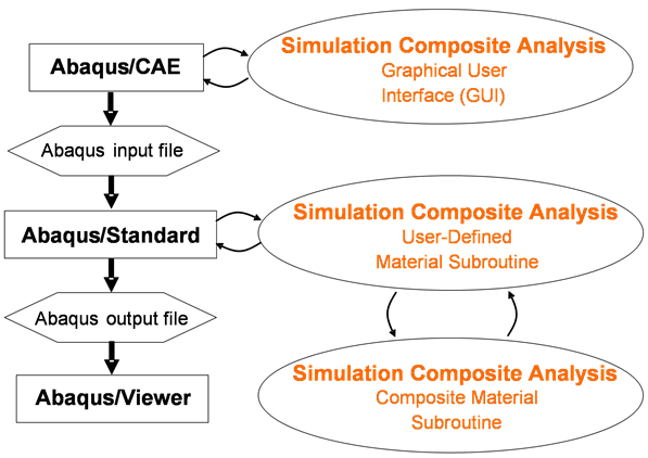

The image below shows a schematic of the individual components of the Simulation Composite Analysis software and their interaction with the Abaqus/Standard software components. Rectangles indicate components of Abaqus/Standard, while ovals indicate individual components of the Simulation Composite Analysis software. The Simulation Composite Analysis Graphical User Interface (GUI) is accessed from within Abaqus/CAE and assists you in defining the Abaqus input file parameters required during a finite element analysis using Simulation Composite Analysis. The User-Defined Material Subroutine (see image below) calculates constitutive relations and computes stresses for the Abaqus/Standard finite element code. The User-Defined Material Subroutine contains all the MCT constitutive relations for the individual constituents (fiber and matrix) and the homogenized composite material. In addition, the User-Defined Material Subroutine contains the constituent-based failure criteria and the nonlinear constituent damage algorithms. These degrade the stiffness of the constituents and the homogenized composite material to reflect the current damage state of the composite. The Abaqus/Standard finite element code calls the User-Defined Material Subroutine at each Gaussian integration point in the model where constitutive relations or stresses are requested.
In the image below, the Composite Material Library stores all of the material coefficients needed to completely define the MCT multiscale material model. Before a particular composite material can be used in a Simulation Composite Analysis-enhanced finite element model, it must undergo MCT material characterization, and a unique material file must be added to the Composite Material Library. As shown below, the User-Defined Material Subroutine opens and reads the Composite Material Library to extract the necessary material coefficients for any composite materials used in the model. Note that material libraries are not necessary for Simulation Composite Analysis cohesive materials. Since the number of inputs required to define a cohesive material are much less than a composite, the entire material is defined within the Abaqus input file.
In addition to the software modules depicted above, Simulation Composite Analysis contains two additional auxiliary programs: Composite Material Manager and xStiff. Composite Material Manager is a stand-alone program allowing you to characterize new composite materials and add them to the Simulation Composite Analysis Composite Material Library. xStiff is a stand-alone program that simplifies the creation of Simulation Composite Analysis-compatible Abaqus input files. It automatically calculates and inserts any extraneous stiffness parameters that are required by elements that use reduced integration. Note that xStiff is not required for analyses that use strictly cohesive materials.
