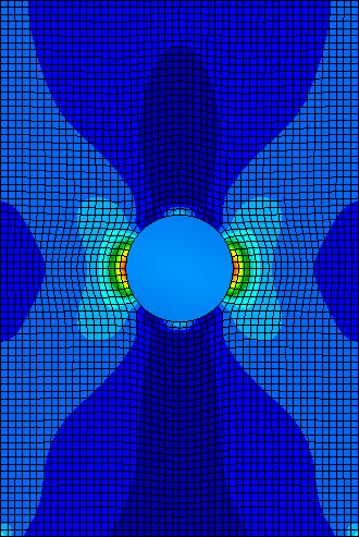

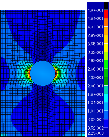

  10. Select SV3, NonLinear Output from the Select Fringe Result window and click Apply.
SV3 represents the matrix failure index. This variable indicates how close the matrix is to failure, which occurs when SV3 is greater than or equal to 1.
The default ply for the contour plot shown above is Ply 8 and the maximum SV3 value is 0.497. This means that in Ply 8, the matrix failure index is less than 1 and no failure has been detected.

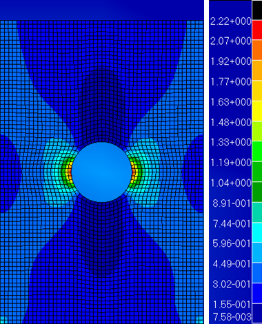

Create an envelope plot to view the maximum matrix failure index in all of the plies. Envelope plots display the maximum or minimum integration point value across all of the section points in each element.
  1. To create an envelope plot, click the Layer button on the Results form and highlight all 8 layers.
  2. Select Maximum from the menu and click OK. Click Apply on the Results form.
    The maximum matrix failure index is 2.22, which indicates that matrix failure is predicted to occur in one or more of the plies.
