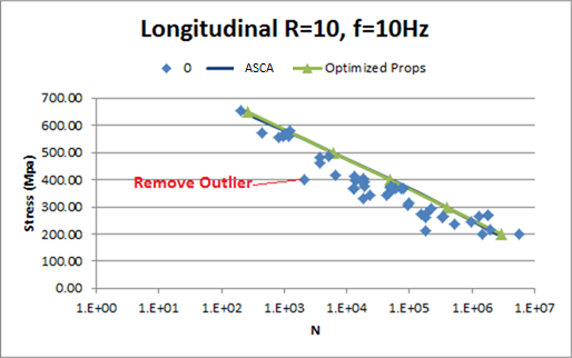

  1. Experimental fatigue data contains a great deal of scatter, and the optimization scheme which determines the best material constants for a fatigue analysis gives equal weight to every data point. You should consider removing outliers from the data used to optimize fatigue properties. This will prevent unlikely S-N data points contributing to the calculation of optimized properties.
  2. The greater the range of cycles to failure provided in the data will provide better optimized properties.
