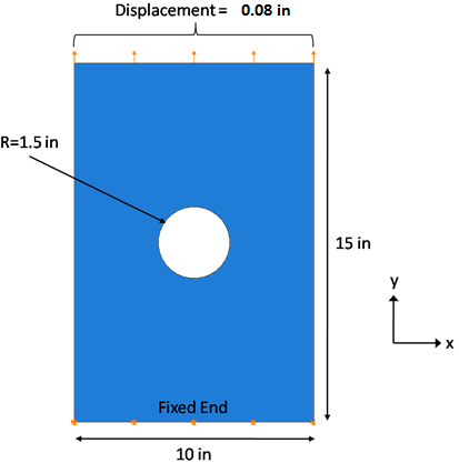

The problem consists of a flat composite plate with a hole in the center subject to fixed boundary conditions on one end, and a displacement controlled load of 0.08" (0.53% of the plate length) on the other end. The plate is made of IM7/8552, the layup is [0/±45/90]s, and the ply thickness is 0.005" which results in a plate thickness of 0.04". The seed size for the mesh is 0.2, and 8-node layered solid shell elements (SOLSH190) are used. The dimensions, boundary conditions, and load are shown below. After the model is created and the finite element analysis is completed, steps are provided to view and interpret the results.
