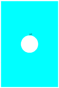

  7. Click Main Menu > Preprocessor > Modeling > Operate > Booleans > Subtract > Volumes.
  8. Select the plate from the Graphics Window. A message will appear noting there are two volumes at this location. Make sure Volume 1 is the Picked Volume and click OK.
  9. Click OK in the Subtract Volumes dialog box.
  10. Select the cylinder from the Graphics Window. Make sure Volume 2 is the Picked Volume and click OK.
  11. Click OK in the Subtract Volumes dialog box. The plate geometry is now defined. The plate should appear as shown below.
