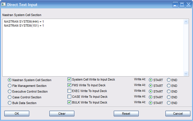

Now check on the System Cell Write to Input Deck, FMS Write to Input Deck, and BULK Write to Input Deck boxes and specify write at Start for each.
Click OK and click Apply on the Analysis form.
