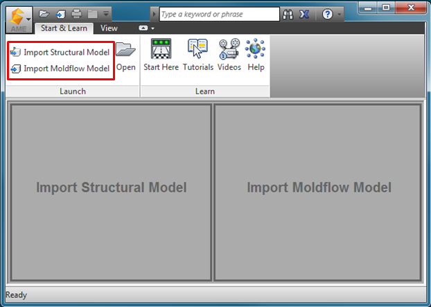

At any point during the product workflow, you may import either the structural model or the Moldflow model. You may complete the importing step in any order. The scenarios below discuss importing at various stages of the workflow.
At this point, both import icons on the Start & Learn tab are active and the display windows indicate you must import each type of model.

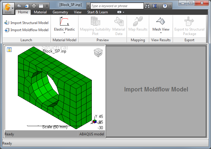

To import the structural model first:
(). The Import dialog appears. The structural model display window will show the imported model and the Moldflow display window will indicate that the Moldflow model needs to be imported.

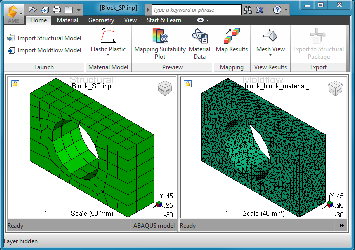

Now, to import the Moldflow model:
(). The import dialog appears. Now both display windows will show the respective models side-by-side. Note that both import icons are still active, allowing you to import new models into the workspace.
