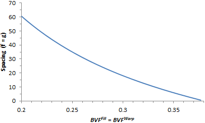

To begin the discussion on recommended parameters, let us first consider the case of a balanced plain weave. This case can be described using a two-dimensional space because the bundle volume fractions and spacing are equal. The plot below shows the relationship between the bundle spacing and the resultant bundle volume fractions for a unit cell of equal width and height (34.04 units). Note that exact units are not important to this discussion, as they are divided out when computing bundle volume fractions. Due to limitations of the meshing algorithm and geometry of the unit cell, the acceptable values of the volume fraction for a balanced plain weave must be between 0.2 and 0.377. If you do not know the exact values of the bundle volume fractions for a balanced plain weave, it is recommended you use a value of 0.375 for both the fill and warp bundle volume fractions.

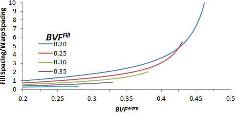

Note that this is inherently a three-dimensional space consisting of the fill volume fraction and the warp volume fraction as a function of the fill gap spacing and the warp gap spacing. To simplify this space and give you a feel for the range of volume fractions associated with the range of spacing, consider the graph below. It shows the ratio of fill spacing to warp spacing as a function of the acceptable range of warp volume fractions for several fill volume fractions. Note that these relationships are easily switched to accommodate a constant warp volume fraction and a range of fill volume fractions. Using the graph below, you can estimate acceptable fill and warp volume fractions knowing the fill spacing and warp spacing ratio. As a general starting point, Autodesk recommends using 0.375 for the bundle volume fraction of the tow orientated with the stiffest material response of the composite.
