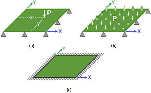

  1. Specify Loading and Boundary Conditions - The Loading Type / Boundary Conditions drop-down menu contains three different combinations of transverse loading and boundary conditions that can be selected:
    • Concentrated Load - SSSS represents a concentrated transverse load acting on a plate with simply-supported boundary conditions on all four of its edges (see part a of the image below).
    • Uniform Load - SSSS represents a uniform distributed transverse load acting on a plate with simply-supported boundary conditions on all four of its edges (see part b of the image below).
    • Uniform Load - CCCC represents a uniform distributed transverse load acting on a plate with clamped boundary conditions on all four of its edges (see part c of the image below).
