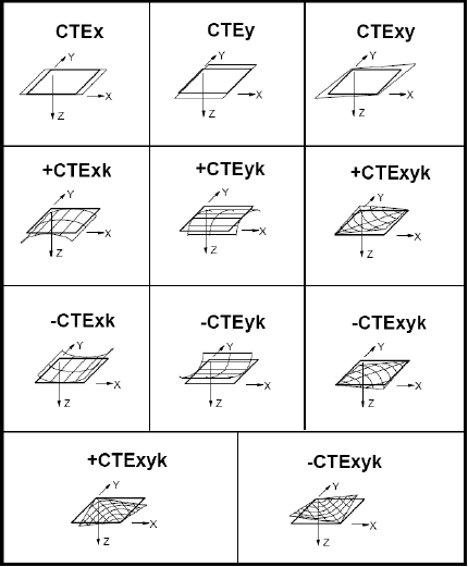

Thermal Deformation Coefficients:
- CTEx (in/in/F)
- Thermal expansion coefficient of the laminate in the global X-direction. This coefficient governs the free expansion or contraction of the laminate mid-plane in the global X-direction due to a uniform temperature change.
- CTEy (in/in/F)
- Thermal expansion coefficient in the global Y-direction. This coefficient governs the free expansion or contraction of the laminate mid-plane in the global Y-direction due to a uniform temperature change.
- CTExy (in/in/F)
- Thermal shear coefficient in the global XY-plane. This coefficient governs the free in-plane shear deformation of the laminate mid-plane in the global XY-plane due to a uniform temperature change.
- CTExk (in/in/F)
- Thermal curvature coefficient in the global YZ-plane. This coefficient governs the free bending of the laminate mid-plane in the global YZ-plane due to a uniform temperature change.
- CTEyk (in/in/F)
- Thermal curvature coefficient in the global XY-plane. This coefficient governs the free bending of the laminate mid-plane in the global XZ-plane due to a uniform temperature change.
- CTExyk (in/in/F)
- Thermal twisting coefficient associated with displacements in the global Z-direction. This coefficient governs the free out-of-plane twisting of the laminate mid-plane due to a uniform temperature change.
Note: The image below shows the free thermal deformation associated with each of the laminate coefficients of thermal expansion and curvature.
