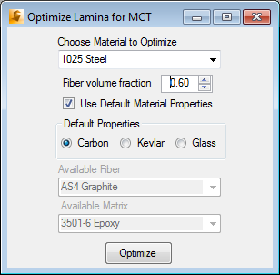

To optimize an existing lamina, navigate to Utilities > Optimize Lamina for MCT. This will open the window shown below.
In this window, you can modify six fields prior to running the optimization step:
  1. Choose Material to Optimize - Select from drop-down menu that lists the lamina located in the data file tree.
  2. Fiber Volume Fraction - Supply the fiber volume fraction for the above lamina.
  3. Use Default Material Properties - Select this box if you want to use a predetermined set of material properties based on the fiber type. This is useful if you do not know any of the constituent properties.
  4. Default Properties - If the "Use Default Material Properties" box is checked, choose one of the available fiber types: Carbon, Kevlar, or Glass.
  5. Available Fiber/Matrix - If the "Use Default Material Properties" box is not checked, choose an available fiber and matrix material. This list is populated with the fiber or matrix materials from the current material library.
After you set up the fields for the optimization process and click Optimize, the process begins. At this point, Simulation Composite Design will let you know that the optimization process is working. Once the optimization step completes, you will be asked to save the optimized material with a new name. This will save the lamina material under the supplied name and the fiber and matrix materials under a similar name with "_Fiber" and "_Matrix" appended to the name. You may be warned of any excessive errors that may have occurred during the optimization. These excessive errors may be a result of incomplete or unlikely material inputs.
