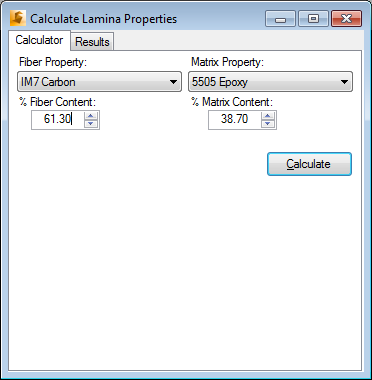

We wish to calculate the lamina properties for a ply containing IM7 Carbon fiber and 5505 Epoxy matrix. The matrix makes up 30.97% of the ply weight.
  1. First we will determine the volume occupied by the fiber constituent. Click Utilities > Vf-Wf Converter.
  2. Select the IM7 Carbon in the fiber type drop-down menu.
  3. Select the 5505 Epoxy in the matrix type drop-down menu.
  4. Enter the known matrix weight of 30.97% in the appropriate box. Click in one of the other three boxes. The window should look like the image below.
We can now use the fiber volume fraction calculated in the last step to determine the lamina properties.

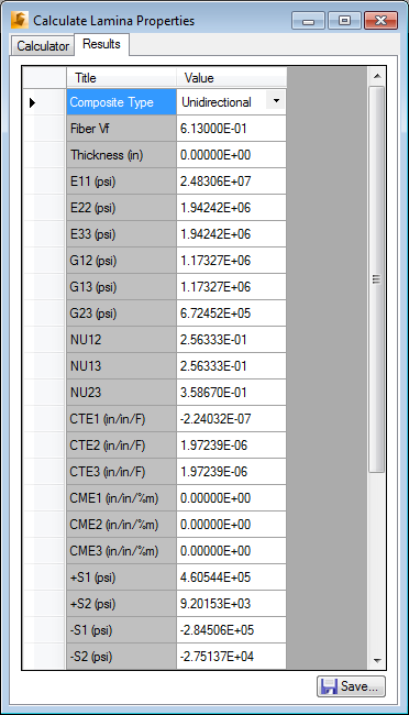

  1. Click New Item > New Lamina from Micromechanics...
  2. In the dialog that appears, select the IM7 Carbon fiber and 5505 Epoxy matrix materials on the Calculate tab.
  3. Enter the fiber volume fraction from above (61.30%) and click Calculate.
  4. The Results tab should now appear as shown below
  5. You may now save the lamina to the material database or easily repeat the process for different fibers, matrices, or fiber volume fractions.
